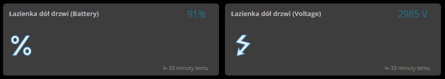

Dodane : 10/08/2021 7:34 am
(@marson)
Wychodzi na to, że coś tam działa. tzn. pokazuje wilgotność i poziom naładowania materii ale temperaturę pokazuje na null, poniżej wynik polecenia:
 sudo journalctl -u zigbee2mqtt.service -f
-- Logs begin at Mon 2021-08-09 20:49:43 CEST. --
sie 10 15:59:38 domoticz. npm[828]: Zigbee2MQTT:info  2021-08-10 15:59:38: MQTT publish: topic 'zigbee2mqtt/0x00124b00239ddec1', payload '{"battery":83.5,"humidity":33.35,"linkquality":168,"temperature":null,"voltage":2900}'
sie 10 16:01:18 domoticz. npm[828]: Zigbee2MQTT:info  2021-08-10 16:01:18: MQTT publish: topic 'zigbee2mqtt/0x00124b00239ddec1', payload '{"battery":83.5,"humidity":32.21,"linkquality":160,"temperature":null,"voltage":2900}'
sie 10 16:02:08 domoticz. npm[828]: Zigbee2MQTT:info  2021-08-10 16:02:08: MQTT publish: topic 'zigbee2mqtt/0x00124b00239ddec1', payload '{"battery":83.5,"humidity":33.66,"linkquality":172,"temperature":null,"voltage":2900}'
sie 10 16:02:58 domoticz. npm[828]: Zigbee2MQTT:info  2021-08-10 16:02:58: MQTT publish: topic 'zigbee2mqtt/0x00124b00239ddec1', payload '{"battery":83.5,"humidity":32.41,"linkquality":180,"temperature":null,"voltage":2900}'
sie 10 16:03:45 domoticz. npm[828]: Assertion failed
sie 10 16:04:19 domoticz. npm[828]: Zigbee2MQTT:info  2021-08-10 16:04:19: MQTT publish: topic 'zigbee2mqtt/0x00124b00239ddec1', payload '{"battery":83.5,"humidity":33.48,"linkquality":176,"temperature":null,"voltage":2900}'
sie 10 16:04:39 domoticz. npm[828]: Zigbee2MQTT:info  2021-08-10 16:04:39: MQTT publish: topic 'zigbee2mqtt/0x00124b00239ddec1', payload '{"battery":83.5,"humidity":33.48,"linkquality":176,"temperature":null,"voltage":2900}'
sie 10 16:05:29 domoticz. npm[828]: Zigbee2MQTT:info  2021-08-10 16:05:29: MQTT publish: topic 'zigbee2mqtt/0x00124b00239ddec1', payload '{"battery":83.5,"humidity":32.24,"linkquality":172,"temperature":null,"voltage":2900}'
sie 10 16:05:49 domoticz. npm[828]: Zigbee2MQTT:info  2021-08-10 16:05:49: MQTT publish: topic 'zigbee2mqtt/0x00124b00239ddec1', payload '{"battery":83.5,"humidity":34.16,"linkquality":172,"temperature":null,"voltage":2900}'
sie 10 16:06:39 domoticz. npm[828]: Zigbee2MQTT:info  2021-08-10 16:06:39: MQTT publish: topic 'zigbee2mqtt/0x00124b00239ddec1', payload '{"battery":83.5,"humidity":33.02,"linkquality":172,"temperature":null,"voltage":2900}'
Wygląda jakby czujnik był walnięty? Chociaż nie chce mi się wierzyć bo to nówka sztuka. Komenda systemctl status zigbee2mqtt pokazuje running na zielono więc też chyba jest OK.

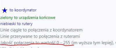

@marson no coś tam działa tylko linkquality 2900 to mało prawdopodobne , u mnie zakres jest taki jak poniżej
3
I bateria w tym czujniku jak na nówkę sztukę coś słaba , u mnie po roku często używany czujnik ma 91% - a to jest niewiele poniżej 3V
