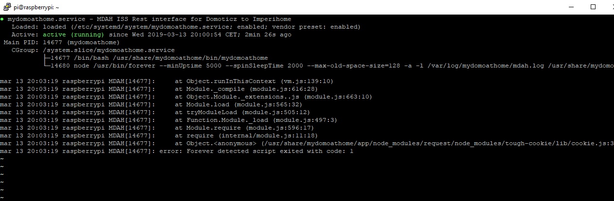

Możesz spróbować
sudo service mydomoathome reload
albo
sudo systemctl daemon-reload
i na koniec
sudo service mydomoathome status
jak usługa nie ruszy to wrzuć fotę z tego statusu
Dodane : 13/03/2019 7:08 pm
gregaicha
(@gregaicha)
Wpisów: 64
cokolwiek to znaczy :)))
● mydomoathome.service - MDAH ISS Rest interface for Domoticz to Imperihome
Loaded: loaded (/etc/systemd/system/mydomoathome.service; enabled; vendor preset: enabled)
Active: active (running) since Wed 2019-03-13 20:00:54 CET; 2min 26s ago
Main PID: 14677 (mydomoathome)
CGroup: /system.slice/mydomoathome.service
├─14677 /bin/bash /usr/share/mydomoathome/bin/mydomoathome
└─14680 node /usr/bin/forever --minUptime 5000 --spinSleepTime 2000 --max-old-space-size=128 -a -l /var/log/mydomoathome/mdah.log /usr/share/mydomoa
mar 13 20:03:19 raspberrypi MDAH[14677]: at Object.runInThisContext (vm.js:139:10)
mar 13 20:03:19 raspberrypi MDAH[14677]: at Module._compile (module.js:616:28)
mar 13 20:03:19 raspberrypi MDAH[14677]: at Object.Module._extensions..js (module.js:663:10)
mar 13 20:03:19 raspberrypi MDAH[14677]: at Module.load (module.js:565:32)
mar 13 20:03:19 raspberrypi MDAH[14677]: at tryModuleLoad (module.js:505:12)
mar 13 20:03:19 raspberrypi MDAH[14677]: at Function.Module._load (module.js:497:3)
mar 13 20:03:19 raspberrypi MDAH[14677]: at Module.require (module.js:596:17)
mar 13 20:03:19 raspberrypi MDAH[14677]: at require (internal/module.js:11:18)
mar 13 20:03:19 raspberrypi MDAH[14677]: at Object.<anonymous> (/usr/share/mydomoathome/app/node_modules/request/node_modules/tough-cookie/lib/cookie.js:34
mar 13 20:03:19 raspberrypi MDAH[14677]: error: Forever detected script exited with code: 1
imperi
Dodane : 13/03/2019 9:07 pm
Wygląda na problem z węzłem node , co ostatnio instalowałeś ? sprawdź wersję
 node -v
i przy okazji
npm -v
powinny być
node v 8.11.1
npm 3.10.3
jak jest wyższa wersja node to będzie problem
