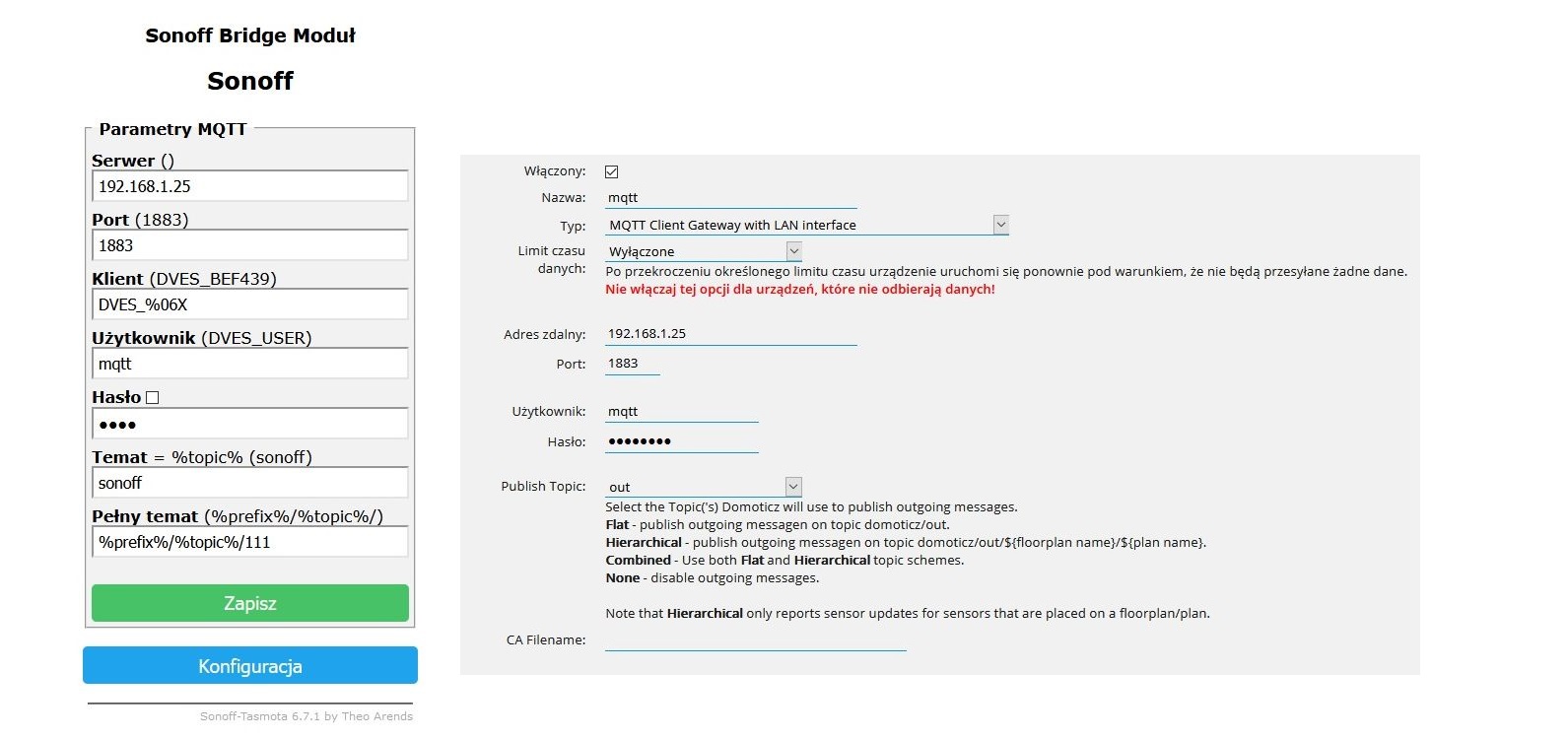

Hej, zainstalowałem na sonoff bridge tastmote, posiadam jeden PIR, w konsoli widać zadziałanie:
12:33:46 MQT: tele/sonoff/111/RESULT = {"Time":"2020-01-08T12:33:46","RfReceived":{"Sync":12730,"Low":460,"High":1220,"Data":"F633FE","RfKey":"None"}}
Natomiast nic nie idzie do domoticza. Na tych samych ustawieniach mqtt bez problemu przesyła wszystko sonoff mini z wgranym AFE. Co mogę sprawdzić, jakie dane tutaj wrzucić abym otrzymał jakąś pomoc.
raspberry pi zero

(@ketonek)
Wpisów: 111
00:00:00 CFG: Wczytane z pamięci flash z F5, Licz 37
00:00:00 APP: Ustaw szybkość transmisji na 19200
00:00:00 Projekt sonoff Sonoff Wersja 6.7.1(sonoff)-STAGE
00:00:00 WIF: Łączenie z AP1 Orange_Swiatlowod_E7B2_2.4GHz w trybie 11N jak domoticz/in-5177...
00:00:04 WIF: Połączony
00:00:04 HTP: Aktywny serwer Web domoticz/in-5177 z adresem IP 192.168.1.21
19:30:33 MQT: Próba połączenia...
19:30:34 MQT: Połączony
19:30:34 MQT: domoticz/in/LWT = Aktywny (Zachowane)
19:30:34 MQT: domoticz/in/cmnd/POWER =
19:30:34 MQT: domoticz/in/INFO1 = {"Module":"Sonoff Bridge","Version":"6.7.1(sonoff)","FallbackTopic":"cmnd/DVES_BEF439_fb/","GroupTopic":"sonoffs"}
19:30:34 MQT: domoticz/in/INFO2 = {"WebServerMode":"Admin","Hostname":"domoticz/in-5177","IPAddress":"192.168.1.21"}
19:30:34 MQT: domoticz/in/INFO3 = {"RestartReason":"Software/System restart"}
19:30:40 MQT: domoticz/in/RESULT = {"Time":"2020-01-13T19:30:40","RfReceived":{"Sync":12580,"Low":450,"High":1230,"Data":"F633FE","RfKey":"None"}}
19:30:42 MQT: domoticz/in/STATE = {"Time":"2020-01-13T19:30:42","Uptime":"0T00:00:16","UptimeSec":16,"Heap":28,"SleepMode":"Dynamic","Sleep":50,"LoadAvg":19,"MqttCount":1,"Wifi":{"AP":1,"SSId":"Orange_Swiatlowod_E7B2_2.4GHz","BSSId":"AC:84:C9:4D:E7:B2","Channel":6,"RSSI":52,"LinkCount":1,"Downtime":"0T00:00:05"}}
19:31:33 CMD: Sync":12730 "Low":460 "High":1220
19:31:33 MQT: domoticz/in/RESULT = {"Command":"Unknown"}
19:32:05 CMD: rule1 on RFReceived#data=F633FE do backlog publish2 RFBridge/Kontaktron1 OPEN; ruletimer1 10 endon on rules#timer=1 do publish2 RFBridge/Kontaktron1 CLOSED endon
19:32:05 MQT: domoticz/in/RESULT = {"Rule1":"OFF","Once":"OFF","StopOnError":"OFF","Free":356,"Rules":"on RFReceived#data=F633FE do backlog publish2 RFBridge/Kontaktron1 OPEN; ruletimer1 10 endon on rules#timer=1 do publish2 RFBridge/Kontaktron1 CLOSED endon"}
19:32:14 MQT: domoticz/in/RESULT = {"Time":"2020-01-13T19:32:14","RfReceived":{"Sync":12570,"Low":450,"High":1230,"Data":"F633FE","RfKey":"None"}}
19:33:07 MQT: domoticz/in/RESULT = {"Time":"2020-01-13T19:33:07","RfReceived":{"Sync":12580,"Low":450,"High":1230,"Data":"F633FE","RfKey":"None"}}
19:33:40 CMD: rule1 on RFReceived#data=F633FE do backlog publish2 RFBridge/Kontaktron1 OPEN
19:33:40 MQT: domoticz/in/RESULT = {"Rule1":"OFF","Once":"OFF","StopOnError":"OFF","Free":440,"Rules":"on RFReceived#data=F633FE do backlog publish2 RFBridge/Kontaktron1 OPEN"}
19:33:56 CMD: ruletimer1 10 endon on rules#timer=1 do publish2 RFBridge/Kontaktron1 CLOSED endon
19:33:56 MQT: domoticz/in/RESULT = {"T1":10,"T2":0,"T3":0,"T4":0,"T5":0,"T6":0,"T7":0,"T8":0}
19:34:01 MQT: domoticz/in/RESULT = {"Time":"2020-01-13T19:34:01","RfReceived":{"Sync":12570,"Low":450,"High":1230,"Data":"F633FE","RfKey":"None"}}
19:35:01 MQT: domoticz/in/RESULT = {"Time":"2020-01-13T19:35:01","RfReceived":{"Sync":12580,"Low":450,"High":1230,"Data":"F633FE","RfKey":"None"}}
Pewnie robię coś nie tak jak się powinno, ale zmiana tematu nie dała nic na chwilę obecną.
Dodane : 13/01/2020 8:36 pm
@ketonek czytałeś to ? https://www.smartnydom.pl/forum/domoticz/router-z-openwrt-domoticz-mqtt-i-bramka-rf/#post-7851
Dodane : 13/01/2020 8:50 pm
(@ketonek)
Wpisów: 111
Dzięki! Teraz komunikuje się z domoticzem. Dostaję takie info w domoticzu:
2020-01-13 21:23:17.352 MQTT: Topic: domoticz/in, Message: {"idx":14,"nvalue":0,"svalue":"16135166","Battery":100,"RSSI":4}

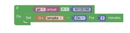

Co prawda jeszcze nie działa prosta komenda jak z załączniku, ale to jakoś ogarnę. Dziękuję bardzo!
