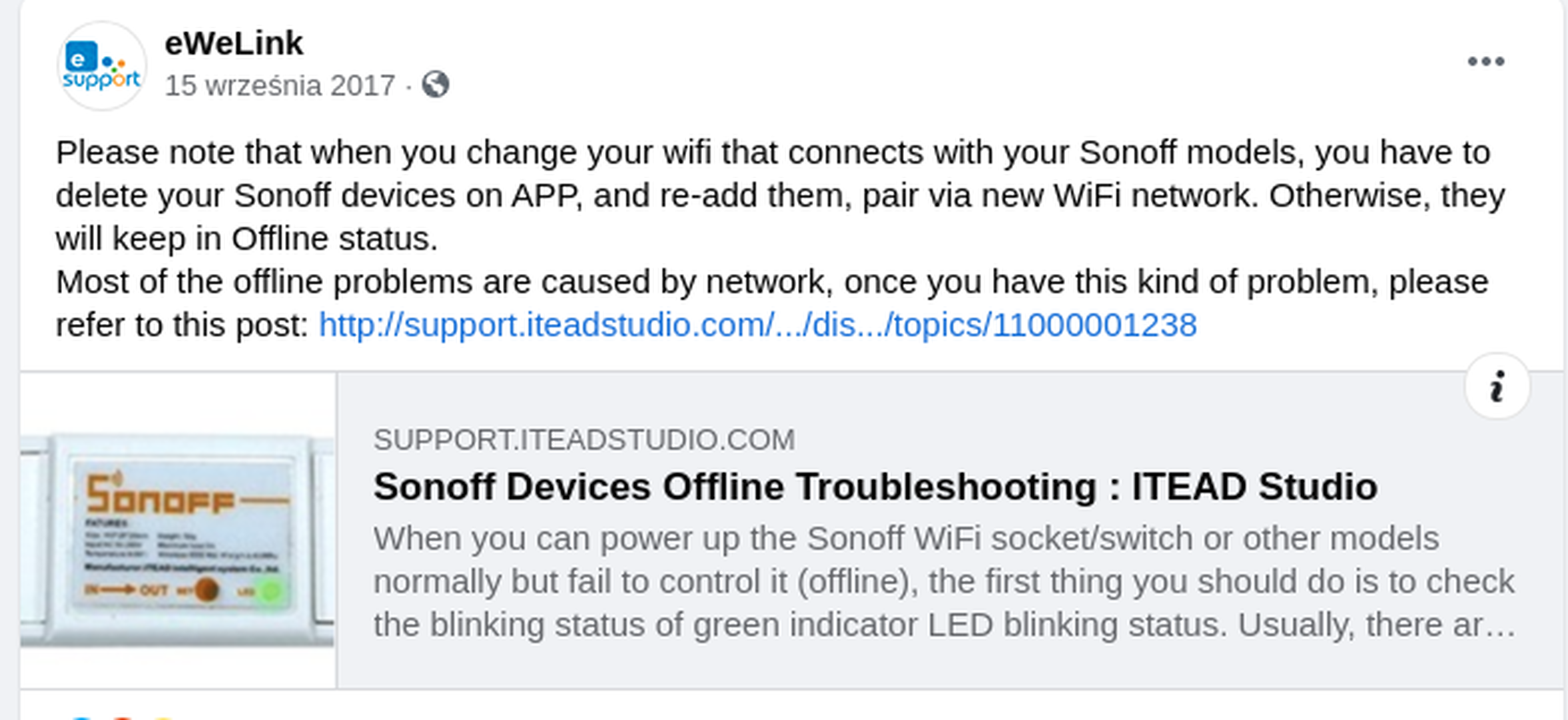

tutaj napisane jest że ustawienie tej samej sieci w nowym router nie zadziała
When you change your WiFi router, the original WiFi SSID and password will no longer work even if you set the same SSID and password on the new router. Therefore, it is necessary you pair all your smart home devices again to the WiFi of the new router.
