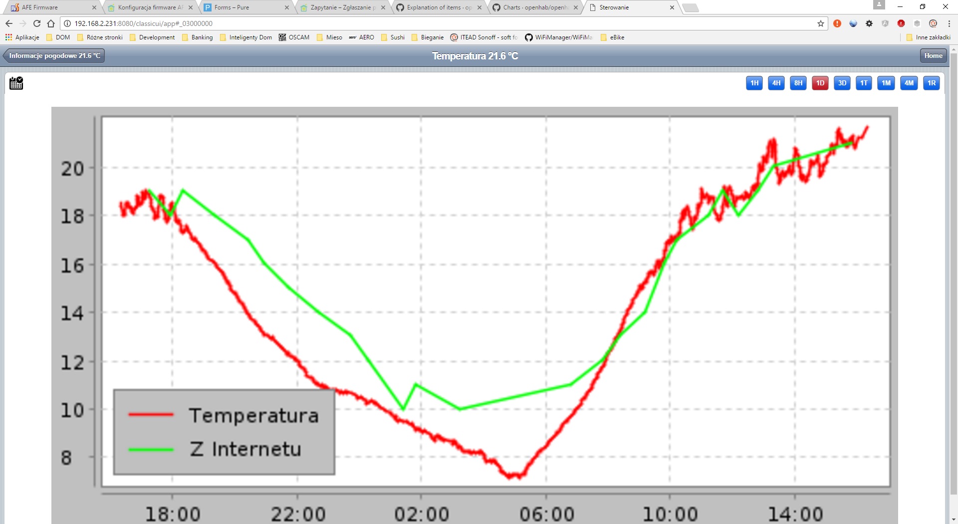

Przykład
w *.items
Group   OutsideTemperaturesComparison
Number temperature_sensor_outside "Temperatura [%.1f °C]" (OutsideTemperaturesComparison)  { ...}
Number  weather_temperature   "Z Internetu [%.1f °C]" (OutsideTemperaturesComparison)   {...}
*.sitemap
Chart item=OutsideTemperaturesComparison period=h refresh=600
Dodane : 13/05/2017 4:26 pm
