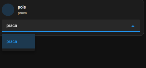

cześć,
korzystam z pomocników tj. pole wyboru. Mam encję, rozwijane menu i wybieram opcję. Problem jest wówczas, kiedy z automatu ustawia się opcja np. za pomocą Node-Red. Po tym po rozwinięciu jest widoczna tylko statnio wybrana. Macie na to jakiś sposób?

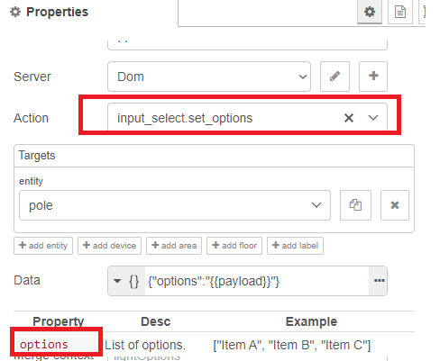

[{"id":"30ed62c9825dd156","type":"tab","label":"Flow 3","disabled":false,"info":"","env":[]},{"id":"b300ad11e4ae8d80","type":"api-call-service","z":"30ed62c9825dd156","name":"pole","server":"3d7533d10bf6d654","version":7,"debugenabled":false,"action":"input_select.set_options","floorId":[],"areaId":[],"deviceId":[],"entityId":["input_select.pole"],"labelId":[],"data":"{\"options\":\"{{payload}}\"}","dataType":"json","mergeContext":"","mustacheAltTags":false,"outputProperties":[],"queue":"none","blockInputOverrides":false,"domain":"input_select","service":"set_options","x":430,"y":160,"wires":[[]]},{"id":"d470e2d8a0ad42f6","type":"inject","z":"30ed62c9825dd156","name":"","props":[{"p":"payload"}],"repeat":"","crontab":"","once":false,"onceDelay":0.1,"topic":"","payload":"dzień","payloadType":"str","x":220,"y":160,"wires":[["b300ad11e4ae8d80"]]},{"id":"d0d6ef6d3c8494f8","type":"inject","z":"30ed62c9825dd156","name":"","props":[{"p":"payload"}],"repeat":"","crontab":"","once":false,"onceDelay":0.1,"topic":"","payload":"noc","payloadType":"str","x":220,"y":80,"wires":[["b300ad11e4ae8d80"]]},{"id":"f4058bcc5800c2f4","type":"inject","z":"30ed62c9825dd156","name":"","props":[{"p":"payload"}],"repeat":"","crontab":"","once":false,"onceDelay":0.1,"topic":"","payload":"rano","payloadType":"str","x":220,"y":120,"wires":[["b300ad11e4ae8d80"]]},{"id":"1c727684af262d87","type":"inject","z":"30ed62c9825dd156","name":"","props":[{"p":"payload"}],"repeat":"","crontab":"","once":false,"onceDelay":0.1,"topic":"","payload":"praca","payloadType":"str","x":220,"y":200,"wires":[["b300ad11e4ae8d80"]]},{"id":"dab9d2d9e79d9476","type":"inject","z":"30ed62c9825dd156","name":"","props":[{"p":"payload"}],"repeat":"","crontab":"","once":false,"onceDelay":0.1,"topic":"","payload":"weekend","payloadType":"str","x":230,"y":240,"wires":[["b300ad11e4ae8d80"]]},{"id":"19203173bbc3463d","type":"inject","z":"30ed62c9825dd156","name":"","props":[{"p":"payload"}],"repeat":"","crontab":"","once":false,"onceDelay":0.1,"topic":"","payload":"poza domem","payloadType":"str","x":240,"y":280,"wires":[["b300ad11e4ae8d80"]]},{"id":"3d7533d10bf6d654","type":"server","name":"Home Assistant","version":5,"addon":true,"rejectUnauthorizedCerts":true,"ha_boolean":"y|yes|true|on|home|open","connectionDelay":true,"cacheJson":true,"heartbeat":false,"heartbeatInterval":"30","areaSelector":"friendlyName","deviceSelector":"friendlyName","entitySelector":"friendlyName","statusSeparator":": ","statusYear":"hidden","statusMonth":"short","statusDay":"numeric","statusHourCycle":"default","statusTimeFormat":"h:m","enableGlobalContextStore":false}]
może to mam źle, taka opcja zadziałała

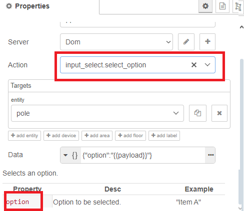

może to mam źle
Sprawdź to, twój przepływ pięknie blokuje selektor 🙂

pawell32 zareagował
Wpisów: 1483
dzięki, porównałem obydwa i znalazłem swój błąd. Jak to jedna litera, której nie widziałem 🙂 zrobiła różnicę. Dobrze wybierałem, tylko nie wiedziałem, czemu ta opcja nie działa. Z rozpędu wstawiałem >options<

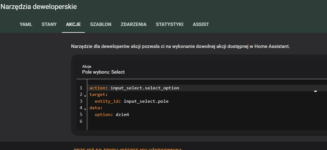

@pawell32 na przyszłość jak będziesz miał wątpliwości masz możliwość sprawdzenia w narzędziach
 Wszystko ładnie gotowe do wstawienia 🙂
