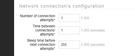

Try this for now (Config panel: WiFi settings). I need to think how to fix it as I more or less know where is a problem
and let me know if it works
