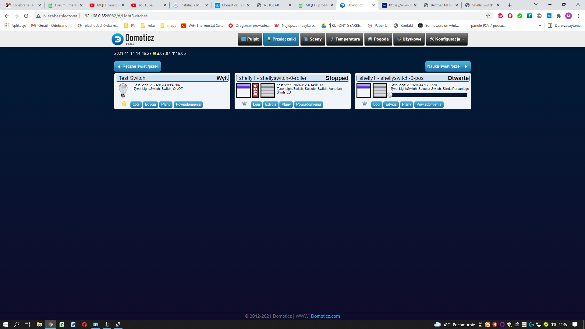

hey podepnę się, u mnie już widać przyciski ale nic one nie robią ...

2021-11-14 14:49:14.091 shelly1: (shelly1) >>> Looking for device: shellyswitch-0-energy
2021-11-14 14:49:14.091 shelly1: (shelly1) MQTT message: shellies/shellyswitch/relay/power 0.0
2021-11-14 14:49:14.091 shelly1: (shelly1) >>> Looking for device: shellyswitch-energy
2021-11-14 14:49:14.092 shelly1: (shelly1) MQTT message: shellies/shellyswitch/roller/0/energy 178
2021-11-14 14:49:14.092 shelly1: (shelly1) >>> Looking for device: shellyswitch-0-energy
2021-11-14 14:49:14.092 shelly1: (shelly1) MQTT message: shellies/shellyswitch/relay/energy 178
2021-11-14 14:49:14.092 shelly1: (shelly1) >>> Looking for device: shellyswitch-energy
2021-11-14 14:49:14.092 shelly1: (shelly1) MQTT message: shellies/shellyswitch/input/0 0
2021-11-14 14:49:14.092 shelly1: (shelly1) >>> Looking for device: shellyswitch-0-input
2021-11-14 14:49:14.092 shelly1: (shelly1) MQTT message: shellies/shellyswitch/input/1 0
2021-11-14 14:49:14.092 shelly1: (shelly1) >>> Looking for device: shellyswitch-1-input
2021-11-14 14:49:14.093 shelly1: (shelly1) MQTT message: shellies/shellyswitch/temperature 67.71
2021-11-14 14:49:14.093 shelly1: (shelly1) >>> Looking for device: shellyswitch-temp
2021-11-14 14:49:14.098 shelly1: (shelly1) MQTT message: shellies/shellyswitch/temperature_f 153.88
2021-11-14 14:49:14.098 shelly1: (shelly1) MQTT message: shellies/shellyswitch/overtemperature 0
2021-11-14 14:49:14.098 shelly1: (shelly1) MQTT message: shellies/shellyswitch/temperature_status Normal
2021-11-14 14:49:14.098 shelly1: (shelly1) MQTT message: shellies/shellyswitch/voltage 234.78
2021-11-14 14:49:17.530 RPi: General/Percentage (Memory Usage)
2021-11-14 14:49:17.536 RPi: General/Custom Sensor (Process Usage)
2021-11-14 14:49:22.062 shelly1: (shelly1) Heartbeating...
2021-11-14 14:49:22.062 shelly1: (shelly1) MqttClient::ping
2021-11-14 14:49:27.542 RPi: General/Percentage (CPU_Usage)
2021-11-14 14:49:27.563 RPi: General/Custom Sensor (Arm Clock Speed)
2021-11-14 14:49:27.589 RPi: General/Custom Sensor (V3D Clock Speed)
2021-11-14 14:49:27.606 RPi: General/Custom Sensor (Core Clock Speed)
2021-11-14 14:49:27.887 InfluxLink: value Percentage,idx=1,name=CPU_Usage value=1.13
2021-11-14 14:49:32.081 shelly1: (shelly1) Heartbeating...
2021-11-14 14:49:32.081 shelly1: (shelly1) MqttClient::ping
2021-11-14 14:49:42.098 shelly1: (shelly1) Heartbeating...
2021-11-14 14:49:42.098 shelly1: (shelly1) MqttClient::ping
2021-11-14 14:49:44.103 shelly1: (shelly1) MQTT message: shellies/shellyswitch/roller/0 stop
2021-11-14 14:49:44.104 shelly1: (shelly1) >>> Looking for device: shellyswitch-0-roller
2021-11-14 14:49:44.104 shelly1: (shelly1) MQTT message: shellies/shellyswitch/roller/0/pos -1
2021-11-14 14:49:44.104 shelly1: (shelly1) >>> Looking for device: shellyswitch-0-pos
2021-11-14 14:49:44.104 shelly1: (shelly1) MQTT message: shellies/shellyswitch/roller/0/stop_reason normal
2021-11-14 14:49:44.104 shelly1: (shelly1) MQTT message: shellies/shellyswitch/roller/0/power 0.0
2021-11-14 14:49:44.104 shelly1: (shelly1) >>> Looking for device: shellyswitch-0-energy
2021-11-14 14:49:44.105 shelly1: (shelly1) MQTT message: shellies/shellyswitch/relay/power 0.0
2021-11-14 14:49:44.105 shelly1: (shelly1) >>> Looking for device: shellyswitch-energy
2021-11-14 14:49:44.105 shelly1: (shelly1) MQTT message: shellies/shellyswitch/roller/0/energy 178
2021-11-14 14:49:44.105 shelly1: (shelly1) >>> Looking for device: shellyswitch-0-energy
2021-11-14 14:49:44.105 shelly1: (shelly1) MQTT message: shellies/shellyswitch/relay/energy 178
2021-11-14 14:49:44.105 shelly1: (shelly1) MQTT message: shellies/shellyswitch/input/0 0
2021-11-14 14:49:44.106 shelly1: (shelly1) >>> Looking for device: shellyswitch-0-input
2021-11-14 14:49:44.106 shelly1: (shelly1) MQTT message: shellies/shellyswitch/input/1 0
2021-11-14 14:49:44.106 shelly1: (shelly1) >>> Looking for device: shellyswitch-1-input
2021-11-14 14:49:44.106 shelly1: (shelly1) MQTT message: shellies/shellyswitch/temperature 67.56
2021-11-14 14:49:44.106 shelly1: (shelly1) >>> Looking for device: shellyswitch-temp
2021-11-14 14:49:44.111 shelly1: (shelly1) MQTT message: shellies/shellyswitch/temperature_f 153.6
2021-11-14 14:49:44.111 shelly1: (shelly1) MQTT message: shellies/shellyswitch/overtemperature 0
2021-11-14 14:49:44.112 shelly1: (shelly1) MQTT message: shellies/shellyswitch/temperature_status Normal
2021-11-14 14:49:44.112 shelly1: (shelly1) MQTT message: shellies/shellyswitch/voltage 234.78
2021-11-14 14:49:47.634 RPi: General/Percentage (HDD /boot)
2021-11-14 14:49:47.638 RPi: General/Percentage (HDD /)
2021-11-14 14:49:52.076 shelly1: (shelly1) Heartbeating...

@pucu U mnie było to:
Custom MQTT prefix w ustawieniach Shelly 2.5 MUSI BYĆ WYŁĄCZONY
Dodane : 14/11/2021 4:11 pm
 pucu
(@pucu)
Wpisów: 26
Praktykant Donator 2K18
@artitu dzięki zadziałało 🙂
