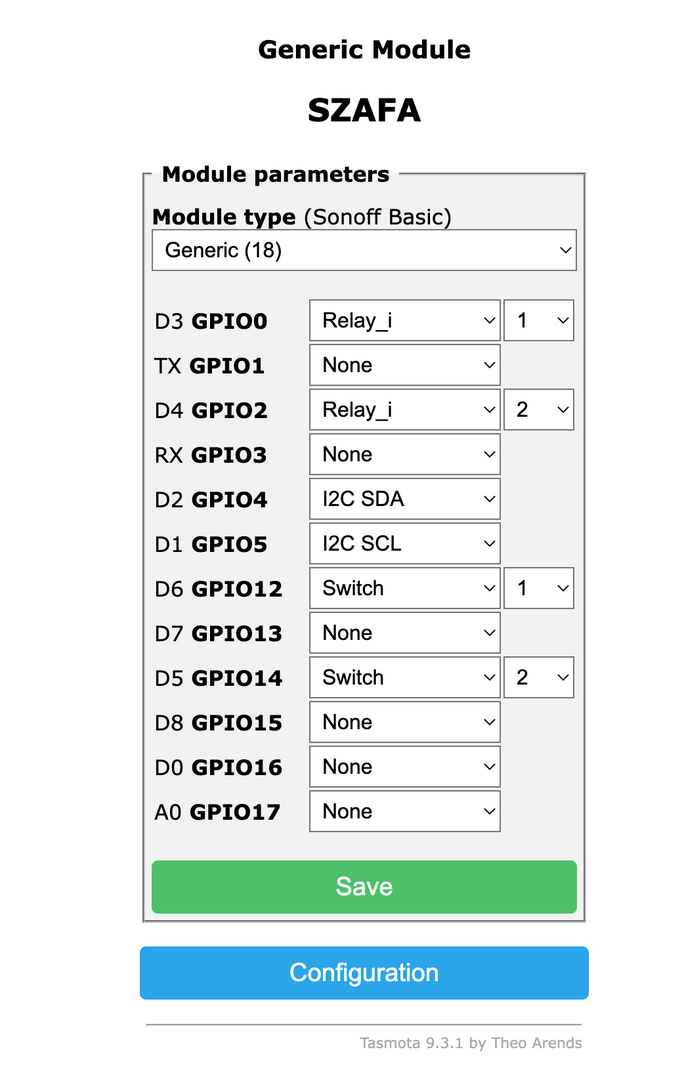

Dzień dobry,
Mam podłączone 2 czujniki PIR1 i PIR2 w Tasmota 9.3.1(sensors)
Zrzut ekranu 2022 07 6 o 22.05.12
 jak wykonuję komendy:
rule1 on switch1#state do publish stat/%topic%/PIR1 %value% endon
SwitchMode1 1
rule1 1
rule2 on switch2#state do publish stat/%topic%/PIR2 %value% endon
SwitchMode2 1
rule2 1
rule3 on system#boot do publish homeassistant/binary_sensor/%deviceid%_motion/config {"name":"PIR1","state_topic":"stat/%topic%/PIR1","payload_on":1,"availability_topic":"tele/%topic%/LWT","payload_available":"Online","payload_not_available":"Offline","device_class":"motion","force_update":true,"off_delay":30,"unique_id":"%deviceid%_motion","device":{"identifiers":["%deviceid%"]}} endon
rule3 1
to tego momentu jest ok, ale wykonując rule4
rule4 on system#boot do publish homeassistant/binary_sensor/%deviceid%_motion/config {"name":"PIR2","state_topic":"stat/%topic%/PIR2","payload_on":1,"availability_topic":"tele/%topic%/LWT","payload_available":"Online","payload_not_available":"Offline","device_class":"motion","force_update":true,"off_delay":30,"unique_id":"%deviceid%_motion","device":{"identifiers":["%deviceid%"]}} endon
dostaję błąd:
20:51:49.641 MQT: stat/szafa_7992DC/RESULT = {"Command":"Error"}
każda rule4 i kolejna wyświetla taki komunikat
W czym może być problem?
ESP Chip Id 7967452
Flash Chip Id 0x164068
Flash Size 4096 kB
Program Flash Size 1024 kB
Program Size 645 kB
Free Program Space 356 kB
Free Memory 21.7 kB
