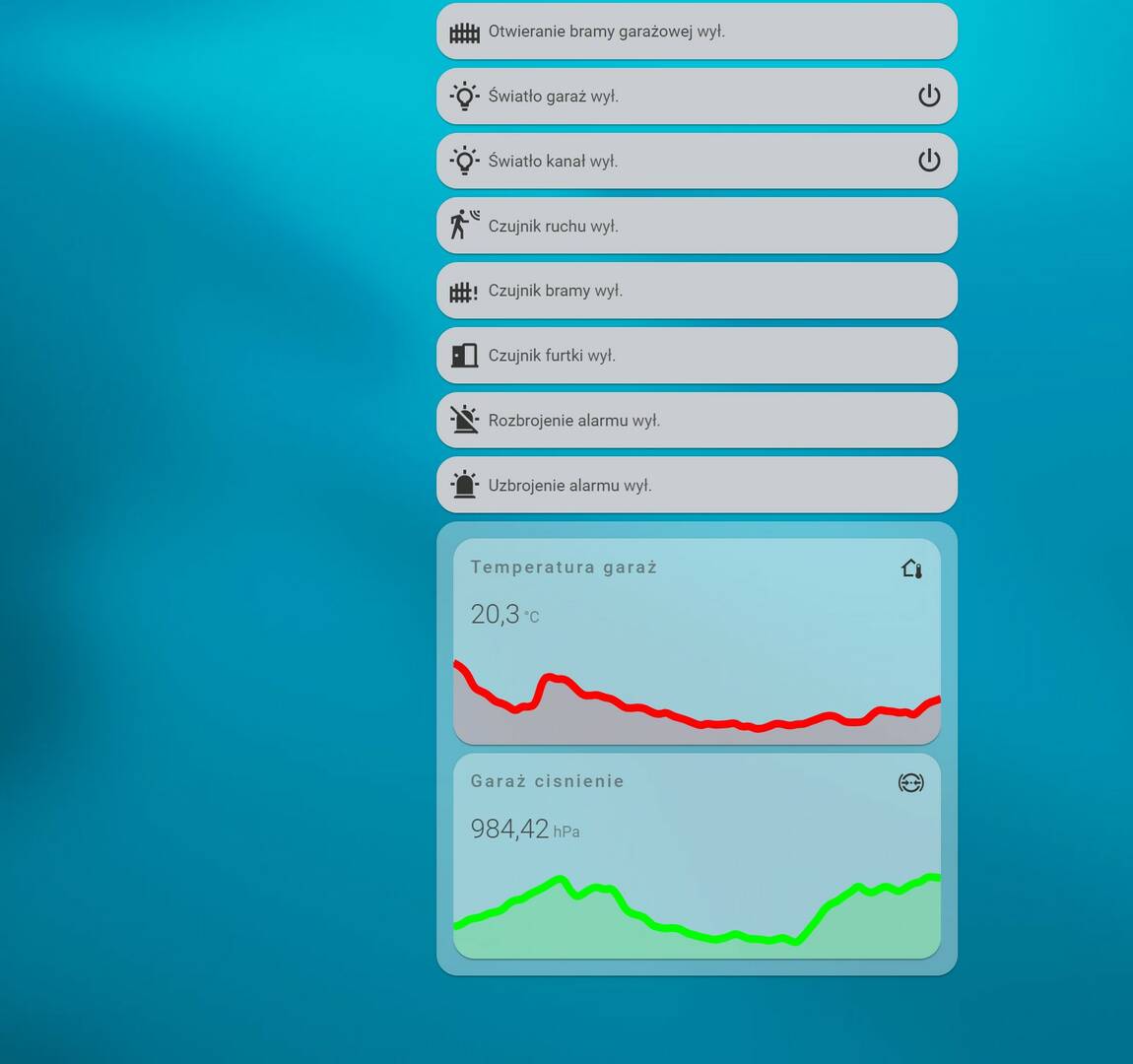

Z BMP280 ja mam tak
dach
Oczywiście musisz jeszcze umieścić wpisy w configuration.yaml
mqtt:
  sensor:
    - state_topic: "zigbee2mqtt/Garaż"
      value_template: "{{ value_json.temperature_l1 }}"
      unit_of_measurement: "°C"
      icon: mdi:home-thermometer-outline
      name: "Garaż cisnienie"
      value_template: "{{ value_json.pressure_l1/100 }}"
      unit_of_measurement: "hPa"
      icon: mdi:car-brake-low-pressure
      name: "Garaż poziom sygnału"
      value_template: "{{ value_json.linkquality }}"
      availability_mode: all
      availability_topic: "zigbee2mqtt/bridge/state"
      payload_available: "online"
      payload_not_available: "offline"
      icon: mdi:signal
