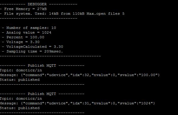

No i są dane 🙂
{"command":"udevice","idx":61,"nvalue":0,"svalue":"3.52"}
{"command":"udevice","idx":62,"nvalue":0,"svalue":"0.1160"}
{"command":"udevice","idx":63,"nvalue":0,"svalue":"0.1160"}
{"command":"udevice","idx":60,"nvalue":0,"svalue":"36"}
I tu też.
{"command":"udevice","idx":71,"nvalue":0,"svalue":"11.13"}
{"command":"udevice","idx":72,"nvalue":0,"svalue":"0.3774"}
{"command":"udevice","idx":73,"nvalue":0,"svalue":"0.3774"}
{"command":"udevice","idx":70,"nvalue":0,"svalue":"114"}
@steel_rat
uff - to jak @isom jeszcze potwierdzi to zamykam ten defekt
@adrian zamykaj ten defekt
 OK
