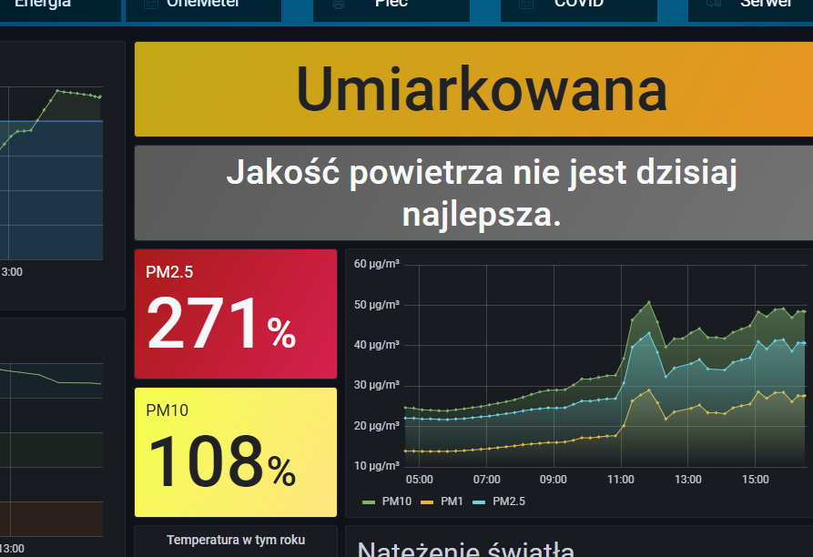

U mnie działa po polsku w takiej konfiguracji:
Thing http:url:airly "Airly" [
	baseURL="https://airapi.airly.eu/v2/measurements/installation?installationId=40420",
	headers="Accept=application/json","apikey=APIkey","Accept-Language=pl",
	refresh=900 ] {
		Channels:
			Type number : cur_PM1 "akt. PM1"			[stateTransformation="JSONPATH:$.current.values[?(@.name=='PM1')].value" ]
			Type number : cur_PM25 "akt. PM2,5"			[stateTransformation="JSONPATH:$.current.values[?(@.name=='PM25')].value" ]
			Type number : cur_PM10 "akt. PM10" 			[stateTransformation="JSONPATH:$.current.values[?(@.name=='PM10')].value" ]
			Type number : cur_pressure "akt. ciśn"		[stateTransformation="JSONPATH:$.current.values[?(@.name=='PRESSURE')].value" ]
			Type number : cur_humidity "akt. wilg"		 [stateTransformation="JSONPATH:$.current.values[?(@.name=='HUMIDITY')].value" ]
			Type number : cur_temp "akt. temp" [stateTransformation="JSONPATH:$.current.values[?(@.name=='TEMPERATURE')].value" ]
			Type string : cur_desc "akt. opis" [stateTransformation="JSONPATH:$.current.indexes[?(@.name=='AIRLY_CAQI')].description" ]
			Type number : percent_WHO_PM25 "Proc. stand. WHO PM2,5" [stateTransformation="JSONPATH:$.current.standards[?(@.pollutant=='PM25')].percent" ]
			Type number : percent_WHO_PM10 "Proc. stand. WHO PM10" [stateTransformation="JSONPATH:$.current.standards[?(@.pollutant=='PM10')].percent" ]
Dodane : 12/12/2022 2:10 am
