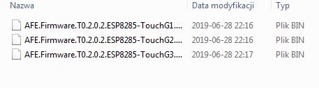

@leonardo  Version T0 2.0.2 is also dedicated to sonoff touch
AFE T 0 v 2.0.2 sonoff Touch

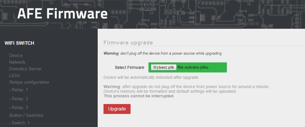

You upgrade the firmware via www.
upgrade firmware
But the sonoff configuration is the default and must be repeated.

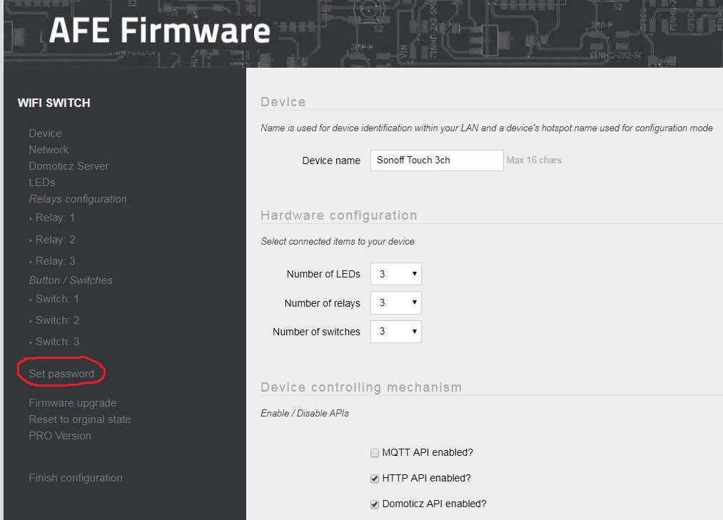

Then you have the module secured
 set password
