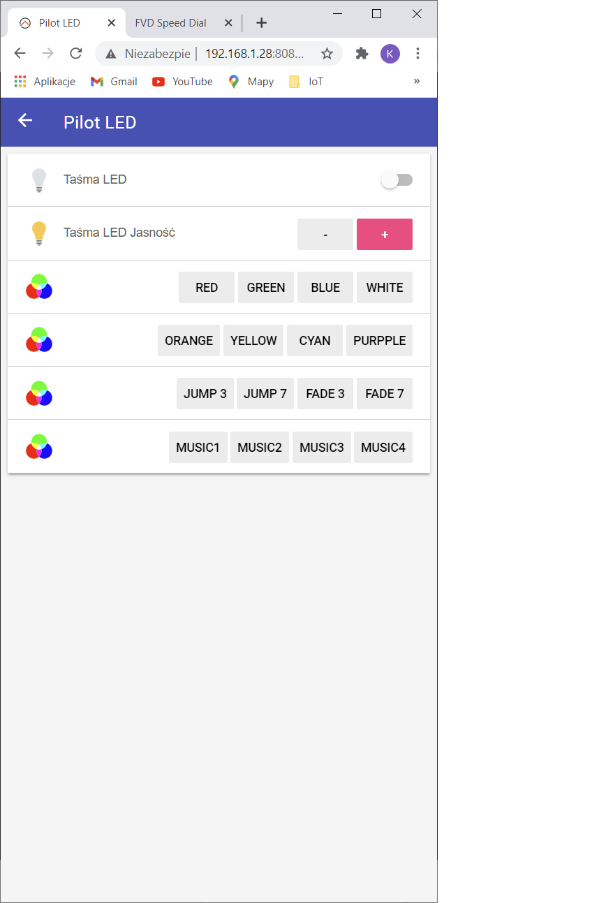

Jak wysłać pojedyncze kody RF z Sonoff Bridge RF z Tasmotą?
Chciałbym stworzyć w sitemap takie coś do sterowania taśmą LED:
Switch item=kolory mappings=["1"="RED", "2"="Blue", "3"="Green", "4"="White"]
Do takiego "wysyłania" potrzebuje pojedyncze things i items ale OH tego nie chce wypuścić do bramki 🙁
Bez problemu idzie zrobić tylko switch on off definiując wartość on off w things ale to tylko 2 wartości a ja potrzebuje kilku.

Udało mi się obejść ten problem - metoda pewnie bardzo lamerska ale dobrze działa.
things
        Type switch : kod1              "Taśma Dorotka ON OFF"  [ stateTopic="stat/sonoff-bridge/RESULT", commandTopic="cmnd/sonoff-bridge/Backlog", on="RfSync 12380; RfLow 410; RfHigh 1150; RfCode #DA3B07", off="RfSync 12380; RfLow 410; RfHigh 1150; RfCode #DA3B08" ]
        Type switch : kod2              "Taśma Dorotka Dim + -" [ stateTopic="stat/sonoff-bridge/RESULT", commandTopic="cmnd/sonoff-bridge/Backlog", on="RfSync 12360; RfLow 410; RfHigh 1170; RfCode #DA3B05", off="RfSync 12380; RfLow 410; RfHigh 1150; RfCode #DA3B06" ]
        Type switch : kod3              "Taśma Dorotka R G"     [ stateTopic="stat/sonoff-bridge/RESULT", commandTopic="cmnd/sonoff-bridge/Backlog", on="RfSync 12360; RfLow 410; RfHigh 1170; RfCode #DA3B09", off="RfSync 12380; RfLow 410; RfHigh 1150; RfCode #DA3B0A" ]
        Type switch : kod4              "Taśma Dorotka B W"     [ stateTopic="stat/sonoff-bridge/RESULT", commandTopic="cmnd/sonoff-bridge/Backlog", on="RfSync 12360; RfLow 410; RfHigh 1170; RfCode #DA3B0B", off="RfSync 12380; RfLow 410; RfHigh 1150; RfCode #DA3B0C" ]
        Type switch : kod5              "Taśma Dorotka O Y"     [ stateTopic="stat/sonoff-bridge/RESULT", commandTopic="cmnd/sonoff-bridge/Backlog", on="RfSync 12360; RfLow 410; RfHigh 1170; RfCode #DA3B0D", off="RfSync 12380; RfLow 410; RfHigh 1150; RfCode #DA3B0E" ]
        Type switch : kod6              "Taśma Dorotka C P"     [ stateTopic="stat/sonoff-bridge/RESULT", commandTopic="cmnd/sonoff-bridge/Backlog", on="RfSync 12360; RfLow 410; RfHigh 1170; RfCode #DA3B0F", off="RfSync 12380; RfLow 410; RfHigh 1150; RfCode #DA3B10" ]
        Type switch : kod7              "Taśma Dorotka JUMP"    [ stateTopic="stat/sonoff-bridge/RESULT", commandTopic="cmnd/sonoff-bridge/Backlog", on="RfSync 12360; RfLow 410; RfHigh 1170; RfCode #DA3B11", off="RfSync 12360; RfLow 410; RfHigh 1170; RfCode #DA3B12" ]
        Type switch : kod8              "Taśma Dorotka FADE"    [ stateTopic="stat/sonoff-bridge/RESULT", commandTopic="cmnd/sonoff-bridge/Backlog", on="RfSync 12360; RfLow 410; RfHigh 1170; RfCode #DA3B13", off="RfSync 12360; RfLow 410; RfHigh 1170; RfCode #DA3B14" ]
        Type switch : kod9              "Taśma Dorotka MUSIC 1" [ stateTopic="stat/sonoff-bridge/RESULT", commandTopic="cmnd/sonoff-bridge/Backlog", on="RfSync 12360; RfLow 410; RfHigh 1170; RfCode #DA3B15", off="RfSync 12360; RfLow 410; RfHigh 1170; RfCode #DA3B16" ]
        Type switch : kod10             "Taśma Dorotka MUSIC 2" [ stateTopic="stat/sonoff-bridge/RESULT", commandTopic="cmnd/sonoff-bridge/Backlog", on="RfSync 12360; RfLow 410; RfHigh 1170; RfCode #DA3B17", off="RfSync 12360; RfLow 410; RfHigh 1150; RfCode #DA3B18" ]
items
SwitchDor_tasma_led_power"Taśma LED []"                       <my_light>           (gBridgeRF)             { channel="mqtt:topic:mqtt-broker:tasmota-sonoff-bridge:kod1", autoupdate="true"
SwitchDor_tasm_led_dim"Taśma LED Jasność[]"                <slider>             (gBridgeRF)             { channel="mqtt:topic:mqtt-broker:tasmota-sonoff-bridge:kod2", autoupdate="true"
SwitchDor_tasm_led_rg"Taśma LED GREEN RED[]"              <rgb>                (gBridgeRF)             { channel="mqtt:topic:mqtt-broker:tasmota-sonoff-bridge:kod3", autoupdate="true"
SwitchDor_tasm_led_bw"Taśma LED WHITE BLUE[]"             <rgb>                (gBridgeRF)             { channel="mqtt:topic:mqtt-broker:tasmota-sonoff-bridge:kod4", autoupdate="true"
SwitchDor_tasm_led_oy"Taśma LED YELLOW ORANGE[]"          <rgb>                (gBridgeRF)             { channel="mqtt:topic:mqtt-broker:tasmota-sonoff-bridge:kod5", autoupdate="true"
SwitchDor_tasm_led_cp"Taśma LED PURPLE CYAN[]"            <rgb>                (gBridgeRF)             { channel="mqtt:topic:mqtt-broker:tasmota-sonoff-bridge:kod6", autoupdate="true"
SwitchDor_tasm_led_jump"Taśma LED JUMP 7 & 3[]"             <rgb>                (gBridgeRF)             { channel="mqtt:topic:mqtt-broker:tasmota-sonoff-bridge:kod7", autoupdate="true"
SwitchDor_tasm_led_fade"Taśma LED FADE 7 & 3[]"             <rgb>                (gBridgeRF)             { channel="mqtt:topic:mqtt-broker:tasmota-sonoff-bridge:kod8", autoupdate="true"
SwitchDor_tasm_led_music12"Taśma LED MUSIC 2 & 1[]"            <rgb>                (gBridgeRF)             { channel="mqtt:topic:mqtt-broker:tasmota-sonoff-bridge:kod9", autoupdate="true"
SwitchDor_tasm_led_music34"Taśma LED MUSIC 4 & 3[]"            <rgb>                (gBridgeRF)             { channel="mqtt:topic:mqtt-broker:tasmota-sonoff-bridge:kod10", autoupdate="true"
Numberpilotled"Pilot led mapping"                  <rgb>                (gBridgeRF)
sitemap
sitemaptest label="Testowe" {
Text label="Pilot LED" icon="remote" {
Switch item=Dor_tasma_led_power
Switch item=Dor_tasm_led_dim                          mappings=[OFF="-",ON="+"]
Switch item=pilotled                label="[]"        mappings=[1=" RED  "2="GREEN "3=" BLUE "4="WHITE "]
Switch item=pilotled                label="[]"        mappings=[5="ORANGE"6="YELLOW"7="CYAN"8="PURPPLE"]
Switch item=pilotled                label="[]"        mappings=[9="JUMP 3"10="JUMP 7"11="FADE 3"12="FADE 7"]
Switch item=pilotled                label="[]"        mappings=[13="MUSIC1"14="MUSIC2"15="MUSIC3"16="MUSIC4"]
Na koniec reguła do sterowania
rules
rule"Tasma_kolory"
when
Itempilotled    received command
then
switch (receivedCommand) {
case1:Dor_tasm_led_rg.sendCommand("ON")
case2:Dor_tasm_led_rg.sendCommand("OFF")
case3:Dor_tasm_led_bw.sendCommand("ON")
case4:Dor_tasm_led_bw.sendCommand("OFF")
case5:Dor_tasm_led_oy.sendCommand("ON")
case6:Dor_tasm_led_oy.sendCommand("OFF")
case7:Dor_tasm_led_cp.sendCommand("ON")
case8:Dor_tasm_led_cp.sendCommand("OFF")
case9:Dor_tasm_led_jump.sendCommand("ON")
case10:Dor_tasm_led_jump.sendCommand("OFF")
case11:Dor_tasm_led_fade.sendCommand("ON")
case12:Dor_tasm_led_fade.sendCommand("OFF")
case13:Dor_tasm_led_music12.sendCommand("ON")
case14:Dor_tasm_led_music12.sendCommand("OFF")
case15:Dor_tasm_led_music34.sendCommand("ON")
case16:Dor_tasm_led_music34.sendCommand("OFF")
end
Efekt jak na zdjęciu w załączniku.
